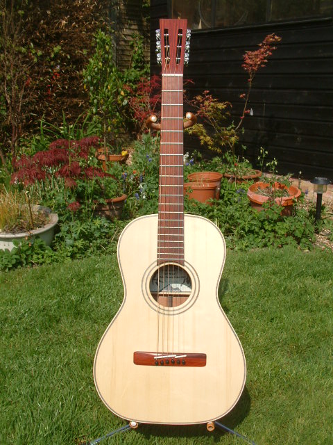

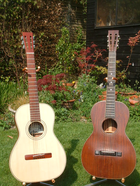

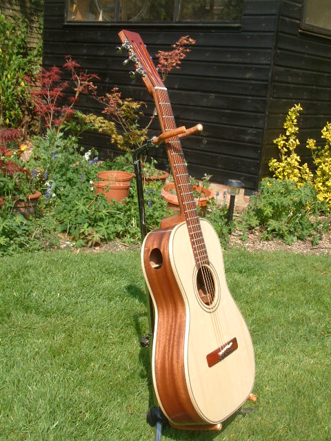

I’ve always been fascinated by small guitars and that’s why I bought an all mahogany concert sized guitar dating from the early years of the last century. This guitar with its flat saddle and high action is perfect for slide guitar with a fabulous growly tone, but impossible to fingerpick. I have made one guitar based on its size and shape but did it with a more modern X bracing scheme. Then John How came along with his take on a ladder braced Oscar Schmidt that was just fabulous and my interest was aroused.
Rather than do what John did – which was to stick to original build except for a cf bar in the neck, a radiused fingerboard and compensated saddle – I wondered what I would have done if ladder bracing was the norm now and I was to build with it as the standard reference point. Being time rich and cash poor and having bits and pieces around the workshop, I decided to make a ladder braced copy of the same size but with the modern touches of my build style. So “Jack the Lad” was conceived and born:

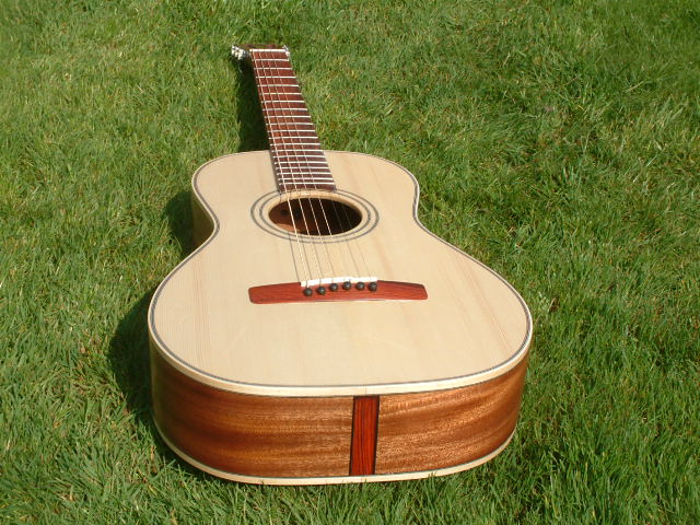

Concert guitar with 624mm scale length (24.57”)
Euro spruce top
Sapele back (4 piece) and sides
Maple bindings with bwb side purflings and bwbbwb top/back purflings
Cocobolo bridge, headstock veneers, fingerboard, end graft and heel cap
Side soundport
Pinned bridge with ebony pins

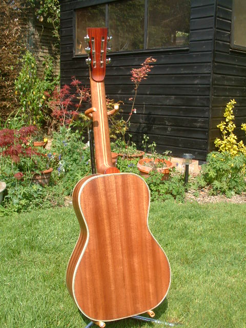

Spanish cedar neck with Lutz spruce/Cuban Mahogany/Lutz spruce centre laminate – adjustable neck system

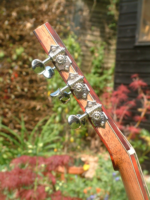

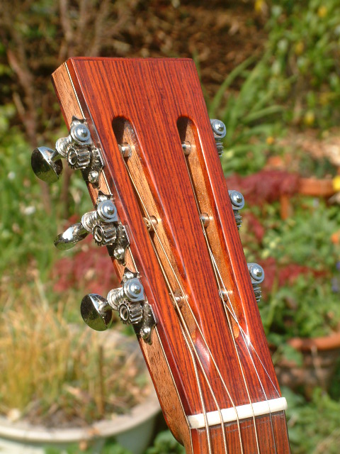

Slotted headstock with Gotoh tuners:
Some pics:
“Jack the Lad” with his mentor:

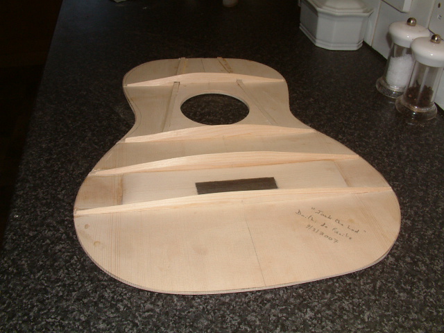

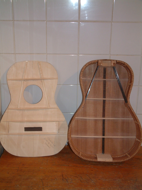

The top bracing is Lutz spruce and was based around the original but adapted for an A frame and soundhole support. The braces are narrow (5mm) but tall and shaped into a triangle and then tapered – my Triabolic bracing scheme. The bridge plate is Lutz spruce with a piece of Brazilian Rosewood inlaid where the pins will sit. The top braces are radiused to 13’ and the back braces to 10’. The back braces are shaped similar to the top and I used my usual cf flying buttress braces:
The guitar finally weighed in at 3lb15oz which is positively heavy compared with the old mahogany guitar which clocks in at 2lb10oz. And now for some sound clips. The guitar is very clear and loud for its size with good projection and lots of sustain. It is a very versatile guitar and sounds great in alternate tunings, but ragtime is very much in it’s armoury so I thought I'd try some ragtime pieces as it seems appropriate for the guitar. They're a little bit boomy as the mike was a little too close I think, but it gives you a flavour of the guitar’s sound. These two are my arrangements from the John James/Pete Berryman record "Sky in My Pie" which I bought back in 1972 in the shop behind Jesus College, Cambridge that sold Transatlantic Record rejects. Most of my guitar influences came from those records! The first is "Mammy O' Mine" and the second "Weeping Willow" - the Scott Joplin rag.
Mammy O' Mine
Weeping Willow
Thanks to the unknown last century builder and John How for setting the example. Thanks for looking and listening.

Dave, that is a neat looking little guitar you have there. It is fascinating to see how nice these little guitars perform. It makes you winder if bigger is indeed better.

Another terrific instrument Dave! I'm always impressed by the great range of instruments you create. I love the sound clip, the Lad sounds great!
This little beauty looks like it should be "at the ready" near your easy chair.

You should be proud of such a fine looking and sounding lad, Dave!

I hope you take this the right way, but Jack the Lad ALREADY sounds like a 100 year old guitar. What beautiful tone!!
It still sounds a little tight, but the potential is truly there. It would be great if you could record a comparison clip in six months time, when that little top has opened up more!!

Sure is a sweet lookin' guitar Dave. Jack seems fairly radical in design . ( I don't think you're allowed to do that mate )   I've been thinking about some of those design features ,and my brain is starting to hurt .

•What are the body dimensions?
•Do you like the soundport in a parlour sized guitar?
•What is the purpose of the CF flying buttress braces?
•Advantages of ladder bracing over the traditional “X” brace?

Anthony - Thanks to you. The headstock binding/purfling was done using that great tutorial that you posted here some time back. As to you questions:
Body dimensions: lower bout width 13 1/4"
                  upper bout width 9 1/2"
                  body length 18 1/2"
                  maximum body depth 3 3/4"
The soundport works really well. I've used it in all types and sizes of instrument - up to baritone size and guitar-citterns. IIt's the best bang for buck I know just for cutting a small hole in the upper bout.
CF butrees braces. I learned this from the work of Mike Doolin, Rick Turnere and Howard Klepper. It gives the neck block support, taking the string stress into the sides, and also helps stop the string tension flattening out the back's longitudinal arch over time and with it changing the neck geometry. It also allows lighter bracing of the top's upper bout area which can contribute better to the sound and lets me do free-floating necks and adjustable neck joints. I've written more about it here on my website.
As to "differences" between ladder and X brace it's a bit too early to tell. Structurally there don't seem to be any - but time needs to take it's toll. Soundwise so far I would say a ladder braces instrument is only different in subtleties of sound. It is a very versatile instrument. Of course a lot depends on what you do with the ladder bracing as it does with X bracing. I've applied the same principles that I always do in my builds.

I really appreciate being able to look at the bracing while listening to the sound clips.
That guitar seems to me to have an incredible amount of mid-range and very little bass. Is that your impression as well or do the recordings deceive me? It's kind of what I would expect from ladder bracing... All that mass concentrated right there at the bridge, and stiffness going only from side to side, the effective soundboard from the butt to just above the bridge.
I've been told about the 'blues' sound of old ladder braced and cigar box guitars, etc, but never really heard a modern recording of what they might sound like live. Now I think I get it... those old blues recordings of Robert Johnson, Blind Lemon etc sound kind of like a guitar piped through AM radio... which is exactly what I'm hearing in your recording.
